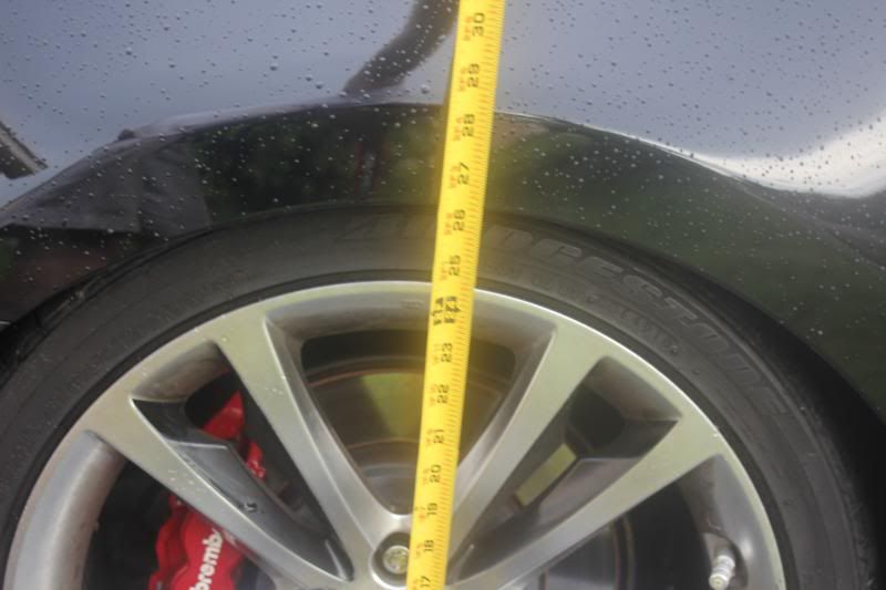

Before Pics: OEM
Rear Height:
Front Height:
Setup:
After Pics:
Rear Height:
Front Height:
